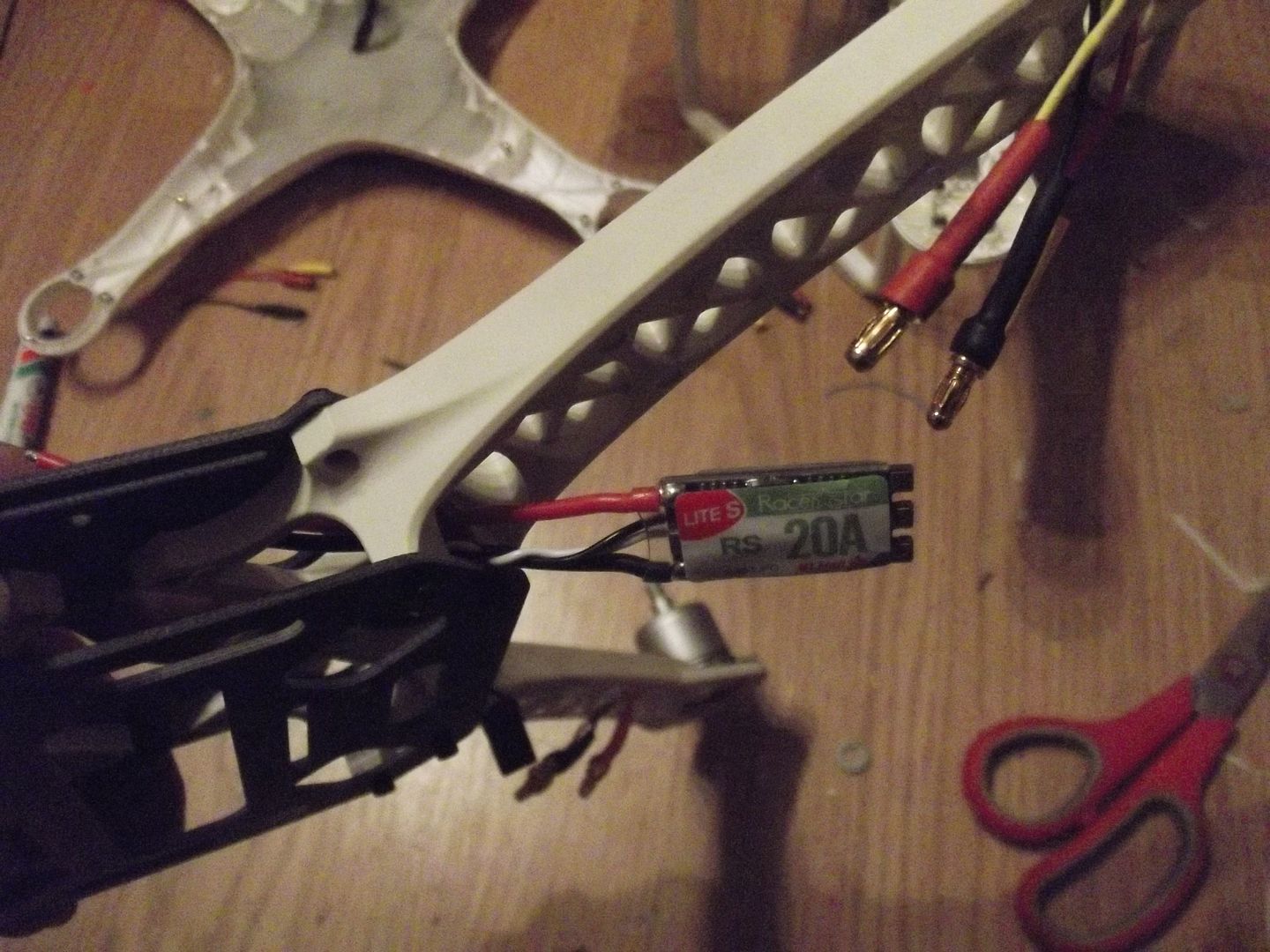

I opened up the P3S shell and removed the motors. Basically clipped the wires. Soldered bullets on and put aside.
The ESC's require tails as they are designed to be hardwired to the motor leads but because I like to be able to repair - will fit tails with bullets on. This also allows me to sort rotation of motors.

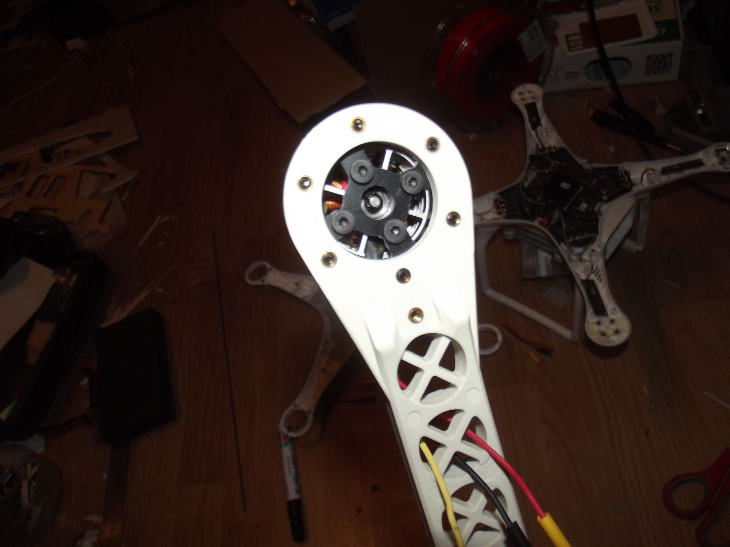

The DJI motors are good for 3 - 4S and being already setup with CW and CCW shafts / props are ideal for this job.
Here is swapping across gear :
Motors perfect fit to plates :
Next is to solder the tails to the ESC's and check rotation ...
Then to start fitting boards / GPS etc.

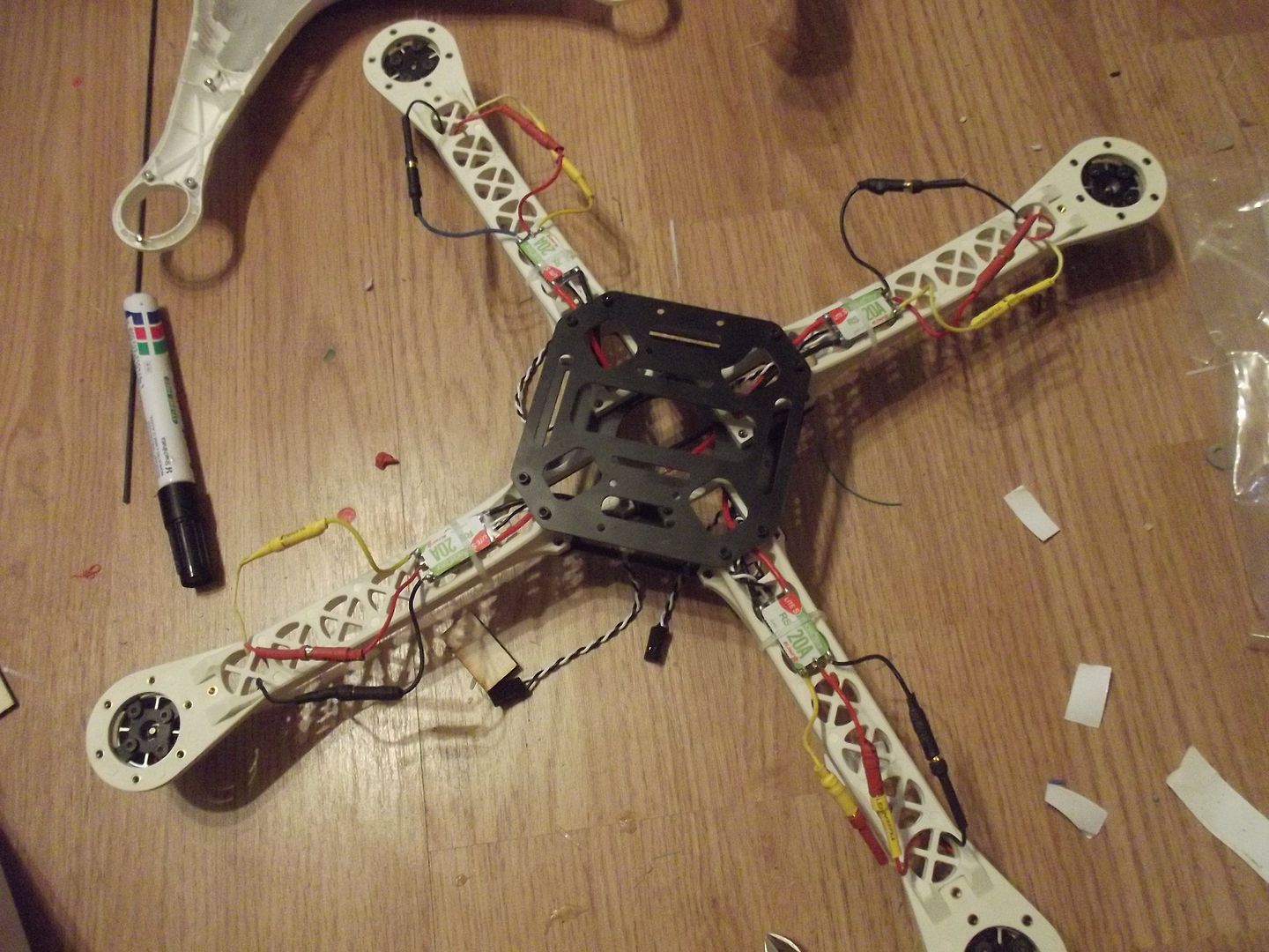

Wiring up is a nightmare of working out where what and how !!
But anyway ... here is the frame partly disassembled to allow wiring up :

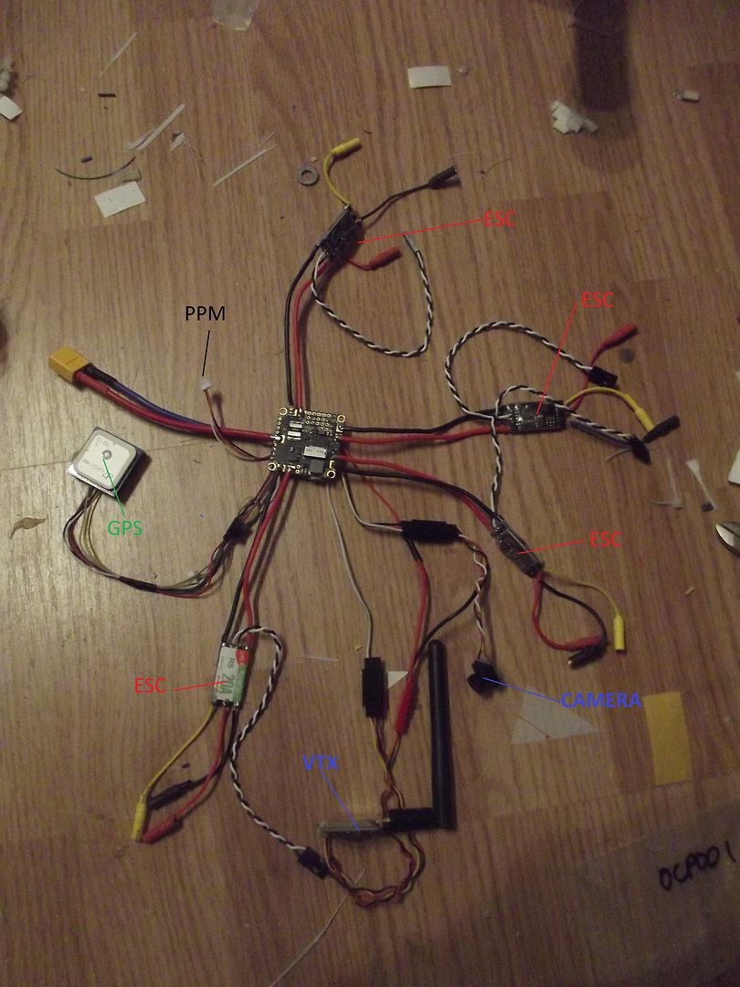

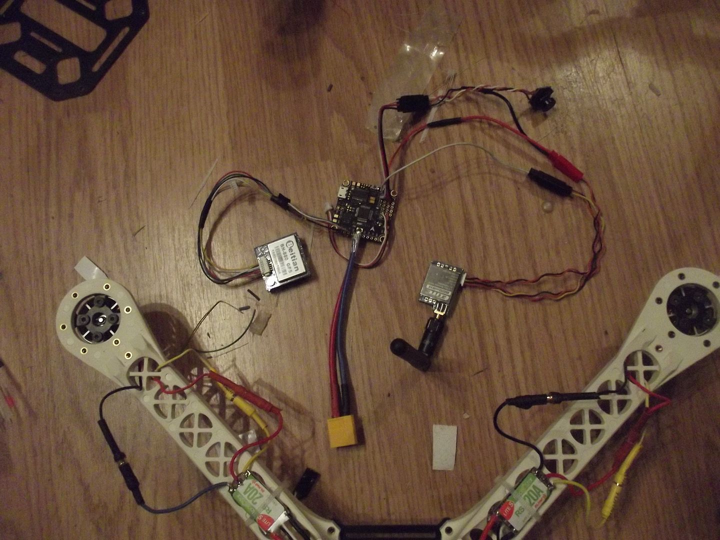

Here's the board with LiPo lead, PPM lead, Camera, VTX and GPS now soldered to it. I elected where suitable to use tails and plugs instead of hardwiring all ...
The Camera / VTX combo had to be split from its original out of box setup, to allow VTX to receive OSD data as well.
The Compass function of course is missing so no autonomous / RTH function possible. But this is a 'concept' job for me having not built one like this before.

Board all wired up now ...
The question remains now will the ESC's vary power based on the FC and not on Rx signal lead as would normally happen.
Old 11-01-2017, 09:38 PM
Posts: 12,370
OK the ESC throttling answered by my pal ... after he studied the board.
On one side of board are large solder pads for main power leads of each ESC ... on other side of board are smaller pads and they are the GND / Signal solder points for ESC control.
The PPM coder I have also supplies the 5V needed for the RX - so no BEC needed.
