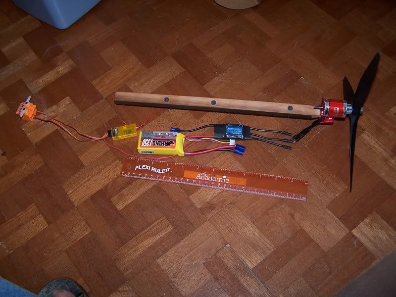

Wow! Photobucket is having a fight with Firefox 5 and Photobucket is winning! The links just won't work properly. Google Chrome to the rescue.
Ok, here's the exploded view of all the electrical components in a Slow Stick, which is a cutaway diagram that flies.
From the front (on the right) and working back we have the brushless motor. It has three wires coming from it to bullet connectors to connect to the three wires from the electronic speed control, which have matching bullet connectors. These wires are all the same color, so there is no way to connect these up in any special way. They all work. However, your motor MIGHT run backwards. If it does reversing any two connections will fix that.
On the back side of the ESC you have a long flat wire harness with a servo connector on it. That goes to the throttle slot on your radio. That is how the radio tells the ESC how fast to run the motor. It's also the data link on my data logging Super Brain ESC but that's another story.
Also coming out the back side of the ESC there are two large diameter wires, red and black which are soldiered into my favorite type of battery connector, the Horizon Hobby EC3 connector. These are VERY easy to soldier and carry amperage VERY well. They're also dirt cheap. I don't see any reason to even consider anything else. Whatever kind of connector you choose, if you use the same kind on all your models you can use all your batteries for all your planes, so long as the cell count is within reason. I wouldn't try the 1300 mAh Rhino in the photo in a Vapor. Might not get off the ground....
You see the red and black wires from the battery going into the matching EC3 connector. There's only one place that can go! It connects to the two battery wires coming from the back side of the ESC. The radio gets its power through the throttle wire, already mentioned.
Of course the servos plug into the correct connectors on the OrangeRX radio you see there.
The two servos are the new Hobby King HK15178 $1.69 servos. They work great, fast, precisely centering and without a glitch, just like $15.00 servos. Or like the $35 servos this guy bought. (at least his a are digital. I remember when just about ANY servos were $35.00) You can even buy gear sets for them, but why would you? The OrangeRX is $7.95 when it's not on sale cheaper. Same deal: it thinks it works for Horizon Hobbies. It's been flawless.
Some people sneer at $1.69 servos and $7.95 receivers. It's a free world. Sneering messes up their facial muscles, not mine. I'm smiling!

I Think I get it. Pictures are so cool. So the Lipo is hooked up to the esc and that esc inturn provides power to the Rx and through out the system?? I hope I asked that correct.

You are correct!
