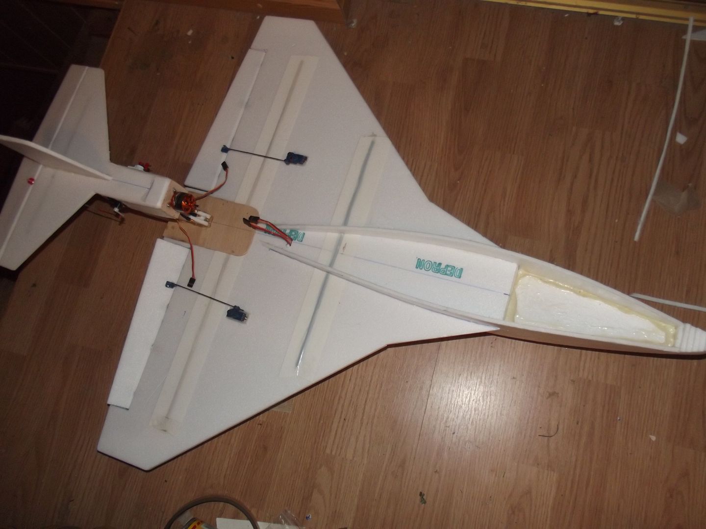

I've been travelling around Caspian and Middle East so only got back last night ...

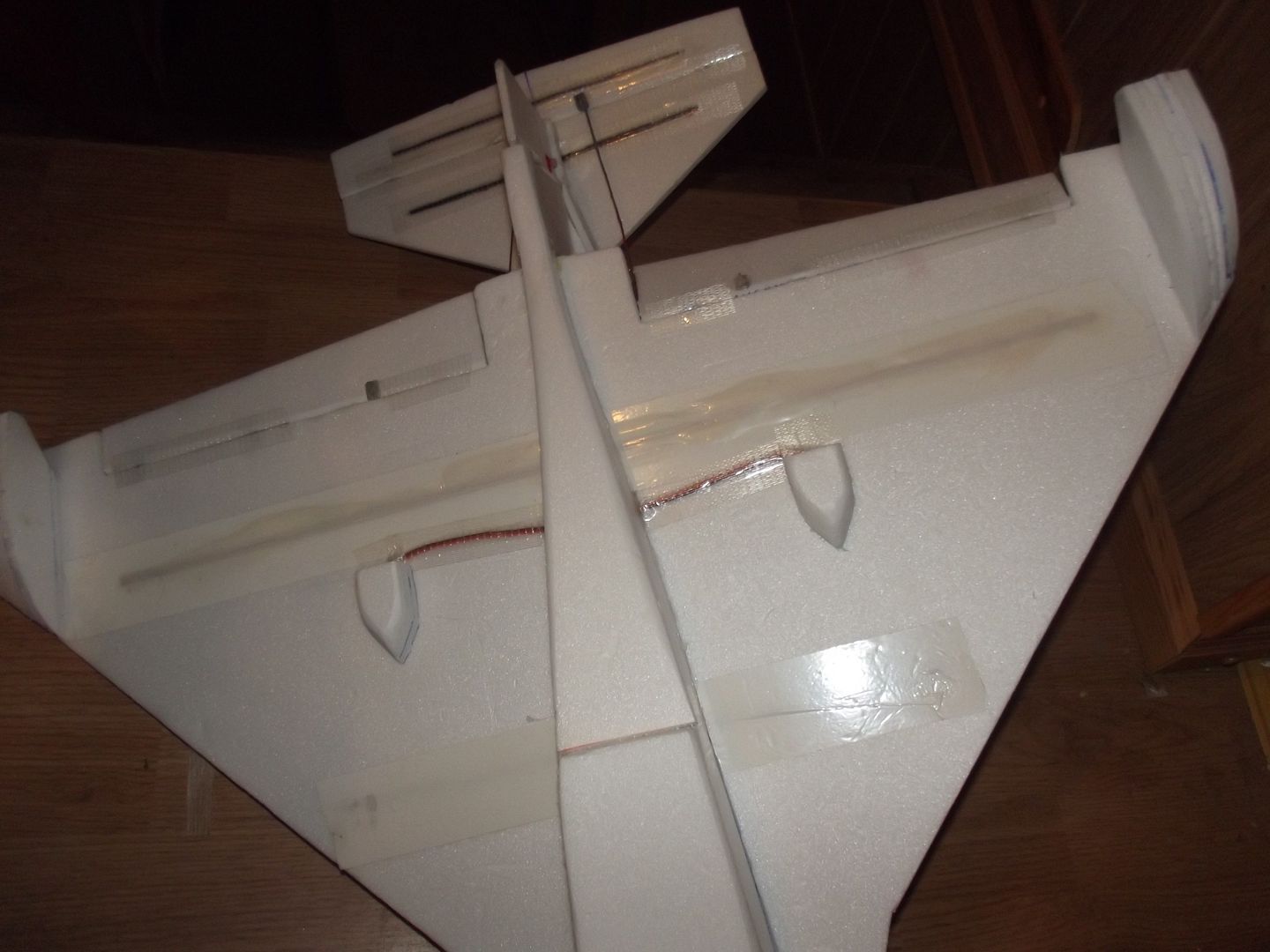

She's about 30% built ...

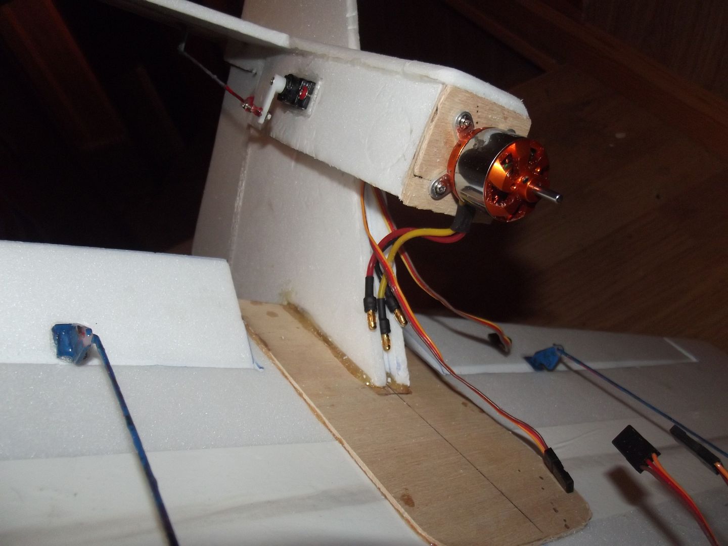

Top view showing the extra large ply plate I use ... this is very light fruit box ply ... stiffens that area really well ...
Closer look ... its epoxied as well to create a really strong bond .. you can also just make out the channel down the front of the fin that servo and motor leads bury into ...
Underside ..
The fin is more stiff and stronger as it doesn't have the internal channel for leads ...
Underside ..

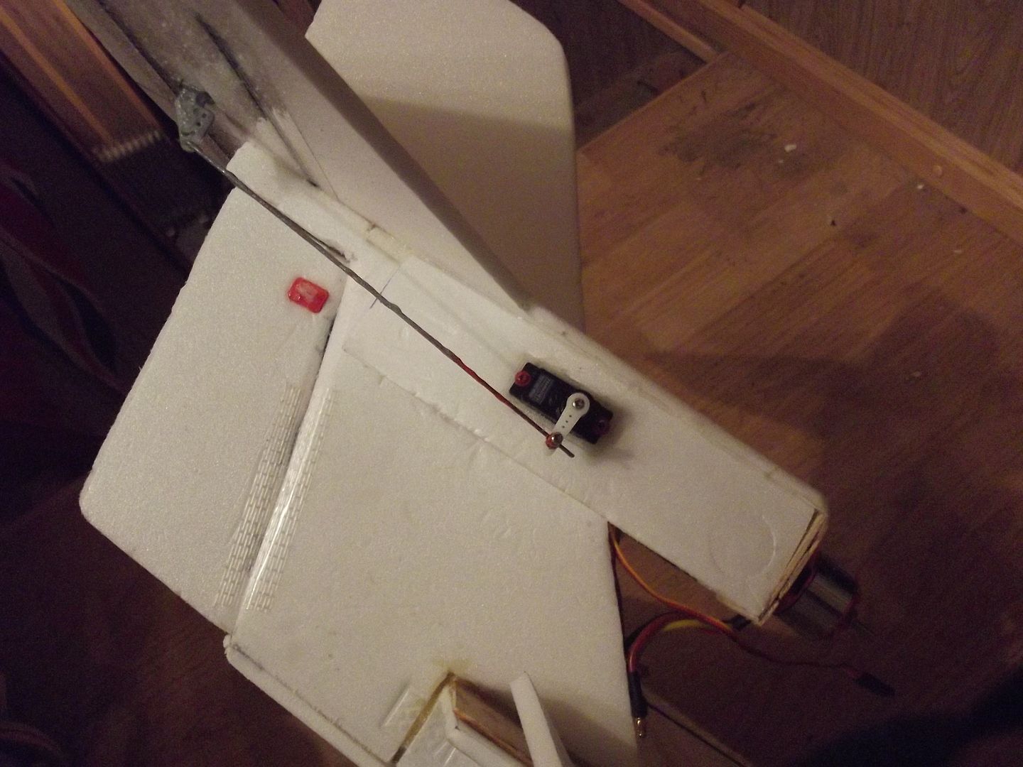

To follow on from my previous showing the larger ply plate ...

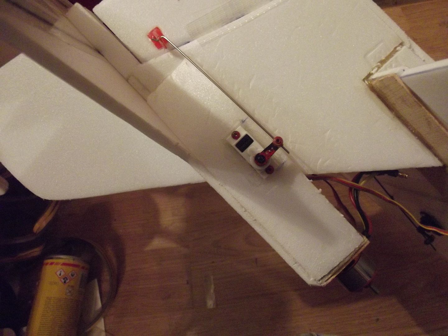

Here is with all coming to top fuselage so no runs inside lower section (ESC / Rx to come) :
Close up of cables and fin leading edge channel ...

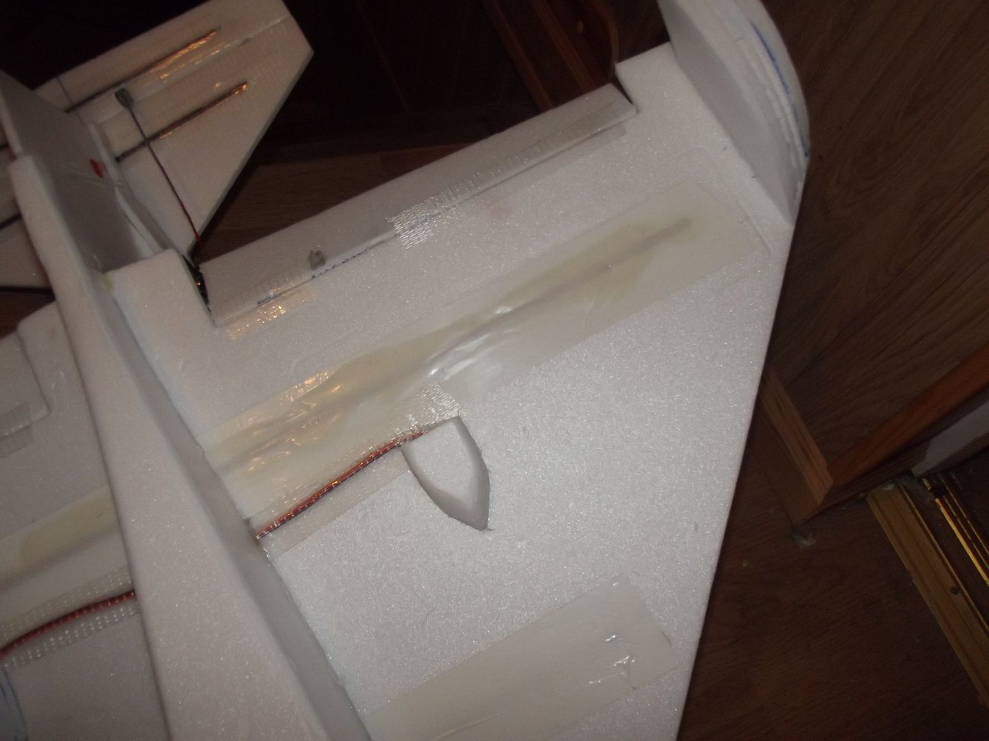

Servos in wing for ailerons ... previous were just unprotected (never had any damage to them) - decided to add foam fairings ...
My sponsons are slightly different in that I altered shape and glued to flat plate before adding to wing - this allowed shaping and getting front edge to match wing more easily. Elevator and stabiliser both have CF ...
Elevator and rudder servos set into the nacelle ...
Just waiting new Rx and ESC from HK to go in there.
