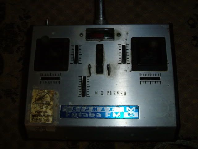

I gave away my **** and invested in the NEW fantastic Futaba !! I coulodn't believe it - PROPORTIONAL control !! AND IT WORKED every time I switched on !
Then I progressed to Futaba M series .... working my way up through the 3ch .. 4ch .. then finally one of the last M's they made - the 6ch :
Now all these had a 6 pin DIN socket to allow Buddy Box Traning ... amazing !
But Oh what a price !!
Nostalgia ... !
