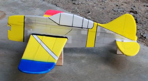

Still waiting on electronics to arrive, but here it is so far..
What I was looking at for the scheme;;;
For some reason, the metalic silver paint did not adhere to the tape well, so it has a few spots, that got touched up.
The bottom of the wing, and stab, are all silver, except the tips, are BRIGHT, so I can see it under my feet.
Fun to build, it only took a few hours to get to this stage.
I did get a few wrinkles in the tape, while I was puting it on...DOH!
I can't wait to finish it, and CrAsH it "FLY IT?"
For a first build, I think it came out okay.
Next one will be better.
When it's airborne, I'll try to get some video...better be quick on the camera.
When my girlfriend saw me masking it off for paint..she just rolled her eyes.
Yesterday I folded the wing on my new high wing 40 trainer, and torpedoed? it in...She saw all the scraps left, and asked if I was going to quit flying yet..?
The oposite...I knocked out a Brewster
If it looks thick...it is! 10mm foam was all I could find locally.
I hate being a 50 year old "KID" living in the middle of nowhere..
I may have a few questions when I get all the components...

Thats a nice lookin Brewster man. When you get the electronics just holla and I will be glad to help. As far as the tape... one of my videos shows this, but you can scotchbrite the tape then paint will stick to it better. Also wash the plane with alcohol before painting. It really looks good I will check back.
Every Brewster you build..they will get better as you learn.

Originally Posted by speedbump View Post
Thanks!
I made the adjustments. Made a new rudder as well, I had already hacked the original.
By the time (the weather clears) I get the nerve to fly it, My new Tx should be here.
I'm looking forward to the maiden flight.
Hopefully I have enough motor to pull around all the glue I used
Not having a hobby shop near by is wearing on my nerves..I had to use "Z" bends at both ends of my piano wire control rods (no adjustment)
I'll change that as soon as the parts arrive in the mail.
I'm taking the video camera for the first flight, just in case it's the last.
I'll keep you posted
Cool
Yes, please do.......always great to see another F2A hitting the skies!

First fight..(3 minutes)
It's a learning curve.
First, turn ON dual rates, second put UP antenna.
anyway, 1/2 throttle, let her go, 3 clicks up up trim, and she's flying straight, and fast. A couple of runs around the field going very easy on the ealerons ( dual rates OFF) oops, I never had a radio with switches, so this was an adjustment, I forgot about, now it's time to see how she climbs,
full throttle, and pointed up...going, going, going...now I can hardly see the little bird, so I get it aimed down, the skies are grey, and the bottom of the plane is silver...oops.
I lost the plane in mid air (like the bermuda triangle)
By the time I get it back in view, I have no control..Tx antenna down DOH!
I keep holding the throttle down stick in hopes that it will regain control..
about 30 feet from the ground headed stright down, the throttle shuts off.
I pulled up enough to get a no thud landing/CrAsH!.
The stress of the hit, did crack the fuse in 2 spots, but nothing that can't be fixed in a few minutes.
The darn thing is fast, and next flight I will try to see how slow it will fly (first)
It's all about learning, and if you can carry the plane home in one hand, it wasn't so bad LOL

Yup been there with this bird fly it real slow. That's why I'm on number 4 I like the speed every time it get's me in trouble. They are easy to repair and quick to cut a new one. It is fun once you get the hang of it. Little epoxy , and some bambo skewers is how I repaired mine gives a little strength to the fuse. Another reason why I never did a fancy paint job knew I would be fixing it.
Meant to tell you, yours came out looking sharp, nice job.
