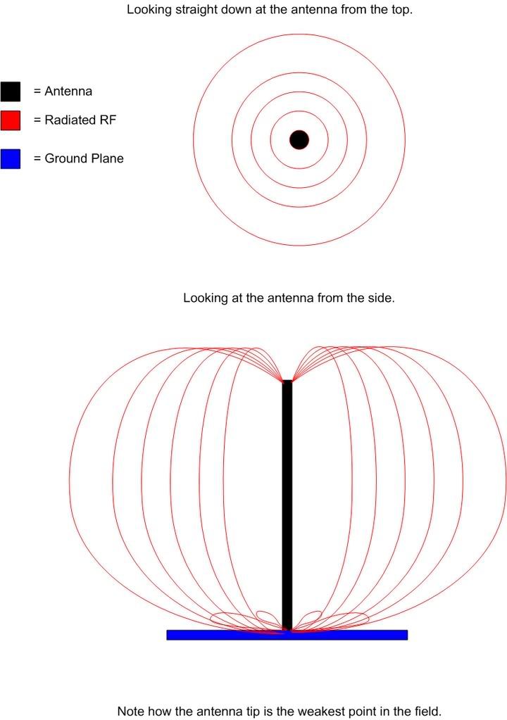

There has been a wonderful job done of troubleshooting in the thread.
I would like to just expand a little for the novice (beginners forum) some posts earlier in this thread.
Antennas and their radiation pattern:
1. The tip of an antenna is the weakest point in the field. See attached pic.
2. Antenna Length is critical to the transmitted pattern.
(Length is based on frequency; Typically 1/4 wavelength)
3. RF radiation is Electrical/Magnetic in nature and any object that can pass an electrical current can either transmit or receive radiated RF.
4. The higher the frequency the shorter the antenna.
(1/4 wavelengths; 27mhz=104"; 72mhz=39"; 2.4ghz=1.17"
5. The distance of an object to a TX/RX antenna can either add to or subtract from the a) TX radiation pattern or b) The RX antenna signal strength.
Note: This is how a TV antenna on your roof multiplies the signal strength. (The rod lengths and spacing have a "gain" effect.
In short (I don't want to get to technical) as we get to using higher and higher frequencies, smaller and smaller objects will cause us more problems. I have a DX7 and Love it, but have to be extra careful about placement.
Just my $0.02 (be gentle with me)
