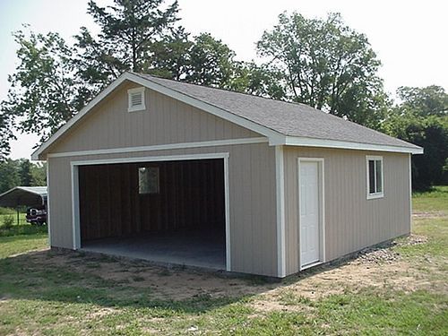

Hi Nigel I have Nitro and Watts in my Blood I Hope you are feeling and getting Better and doing lots of flying and building I am getting ready to have a garage built in my back yard, it will be 24' x 24' with a 16' 2 car garage door a 3x5' window and a 36" Door on the side, it will look something like this, This will give me some place out of the weather to work in Take care and Stay Sweet, Chellie
